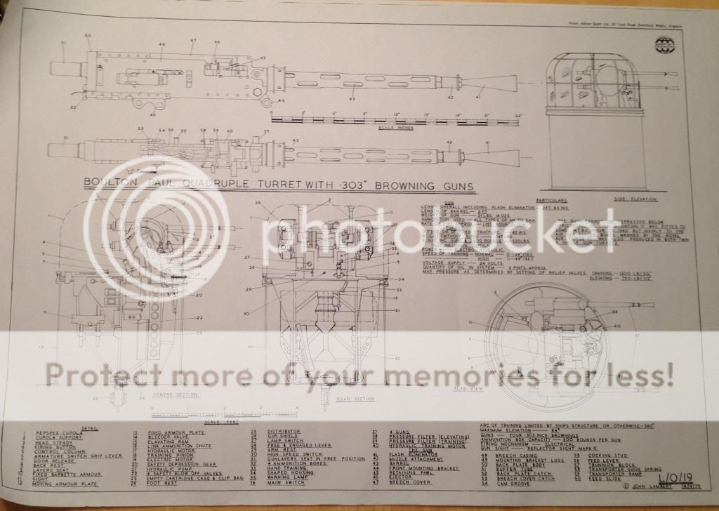

Hi Mike, I found this one in my files. http://i1025.photobucket.com/albums/y317/turret_mike/browning303-3.jpg~original I updated the link to original file option. http://i1025.photobucket.com/albums/y317/turret_mike/browning-1.jpg~original Regards,

Mike, that is more than great. Many, many thanks. The plan and elevation are very desirable. Do you know the source? One thing has struck me. The outer barrel case is show as tapered to the front. Looking hard at one of the photos I have, I think I can see it now there as well. What a surprise! Mike, do you happen to have the key to the part numbers shown. I struggle to find sensible names for the parts since I am completely clueless about guns. Best wishes to all Mike

Here's the source drawing for the gun plan & elevation I posted earlier. I'm sorry for the quality. http://i1025.photobucket.com/albums/y317/turret_mike/L_0_19.jpg~original
